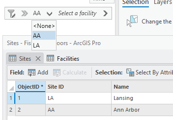

How do you configure the Floor Filter to display the Name field?
It is currently displaying the Site ID field.
In my snip below, instead of AA or LA, I need the drop down in Floor Filter to show Ann Arbor or Lansing.

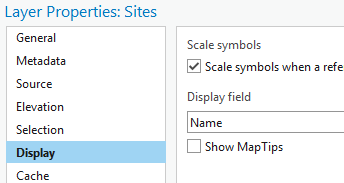

On the Site layer, my display setting is set to Name.

After working with Esri Support, this is a bug - BUG-000169918 ArcGIS Indoors floor filter fails to read domain descriptions for the Sites feature layer.
Work around is to disable the domain on the Site_ID field and populate the Site ID with the descriptive name for the site.
