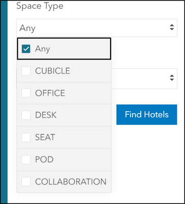

MichaelJenkins
Would that also add a new "lactation station" filter for the Space Type?

GauravJobanputra
@MichaelJenkins you could use your example as an option OR create a restricted Area exclusively for Lactation Stations and add corresponding units from the building to them and only assign individuals who qualify. This way it is only available to the assigned occupants to ensure proper usage.
MichaelJenkins
Right, I asked the wrong question.  If you add a "Storage room" to a new hotel called "Lactation Stations" would you end up with "Storage room" in the space type filter?
GISP
GauravJobanputra
You would ideally change the UseType from the Properties popup to match the new purpose of the unit.
MichaelJenkins
Got it.   Whatever you call it in UseType will end up in the Space Type filter list, but only for users assigned to the hotel it is in.   Thanks!
