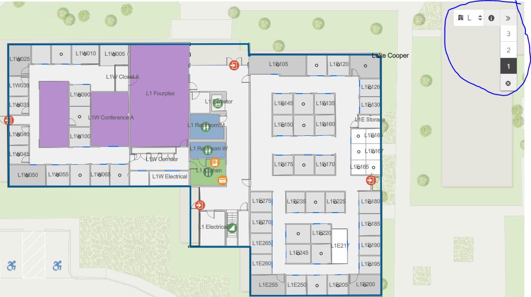

Ive been looking at the Redlands Demo Project and Ive found that the webmap opens automatically to L1 in the building, which is great. My Indoors models works perfectly however the default view always needs you to click on the facility first before you get the level/range rocker to pop out. Where can I find this configuration?

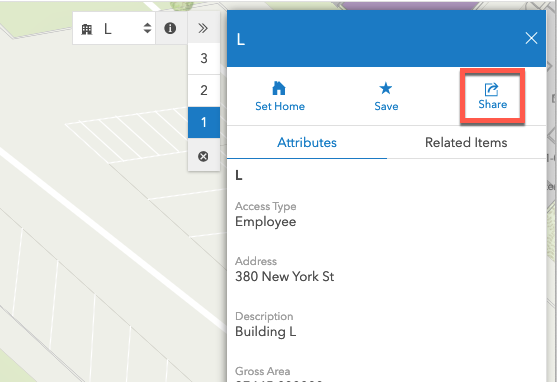

Finally, you can have the app open to a particular building by utilizing the "Share" capability.  Open the application and click on the desired building to activate it.  Once the info card for the building is open, click on the "Share" action and copy the URL to the clipboard.  Paste that URL into a new browser tab and the app will load with that building activated and the floor filter open.
