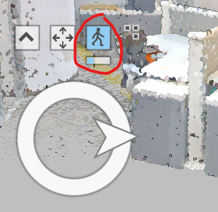

I learned something new today: In addition to Roam Mode, there's also a First-Person Navigation option that allows navigating an indoor point cloud using the arrow keys. To enable it, on the Navigate section of the Map ribbon, click the Explore dropdown and choose First-Person Navigation, or you can click this button on the Navigator UI:
As an old-school FPS gamer, I'm finding the First-Person Navigation mode easier to use than Roam Mode. Check it out!
