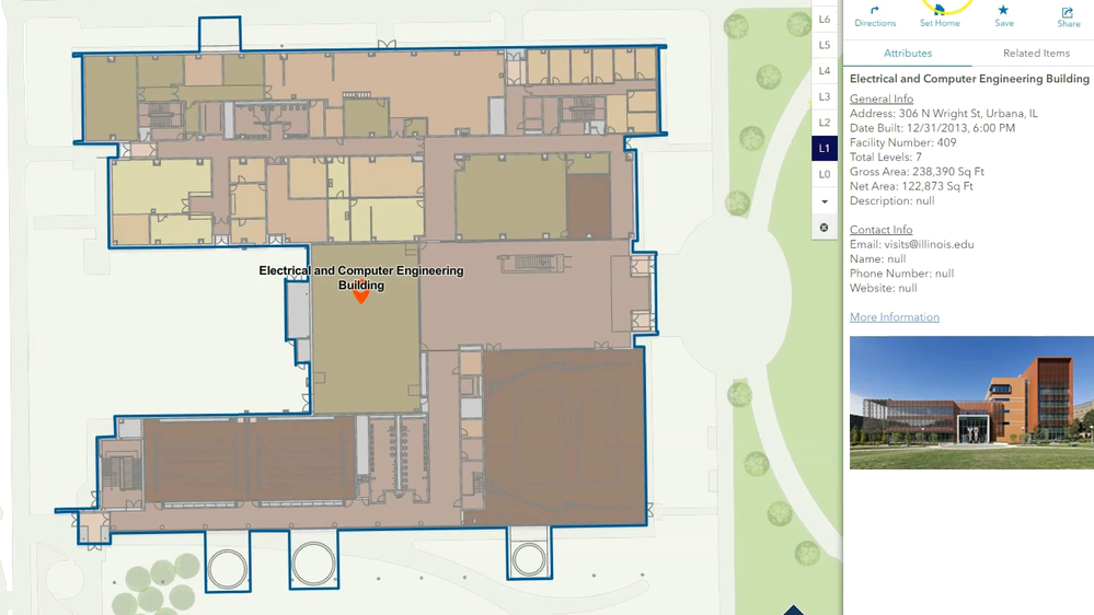

Campus Facility Viewer: Combining building photos with the floor-aware Indoor Viewer is a great way to share a high-level overview of facility data with both staff and the general public.

Floor filter widget
This widget is available in Map Viewer when a floor-aware map is opened. It allows you to filter data displayed by feature layers, point scene layers, and 3D object scene layers based on floor levels.
