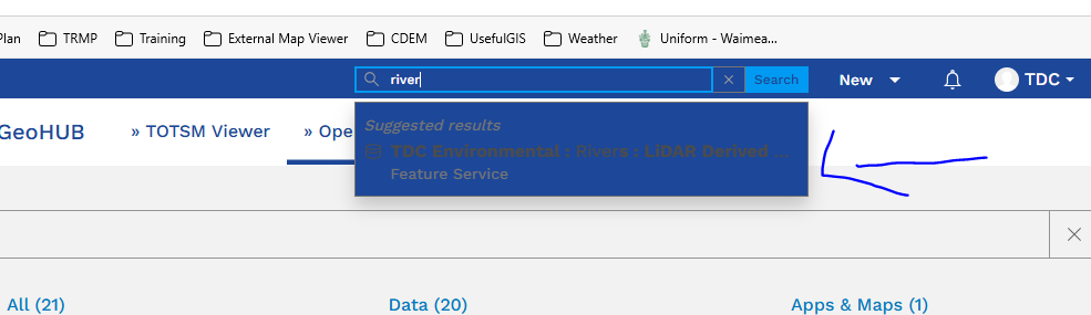

We are setting up a new Hub and Open Data site to go live next week.
During UAT one of our users noticed that the search results were not readable due to dark text on a dark background.
It looks to be a combination of "Global Nav Background Color" and "Body Text Color"
Ideally this drop down results panel should have the same background as the "Body Background Color" instead of "Global Nav Background Colour"
See screenshot
To be clear, it is not the Global Nav bar that is the issue, its the results panel underneath.
I think that you're correct. I'm bringing this to the attention of the ArcGIS Hub team to investigate what's happening.

Yes, it was a bit weird, even if we bring it back to:
nav text with nav background
or
body text with body background
etc.. something to pair up the combination
But, as a side note, it might be worth mentioning the lighter gray headings in that dropdown space as well, I couldn't find where those were being defined.. they might not have a configurable attribute in the Theme tab yet.
Correct. This gray text in the auto-suggest menu is not configurable.
We've logged a bug internally to investigate and repair.

@MelissaBrooks Can you confirm if you are still observing this issue. The team released an update that should have resolved the theme color issues with the autosuggest menu (assuming that the site's branding colors pass contrast.) Let us know!
