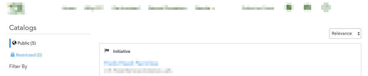

No Collections
site search page showing header, facets, and results, collections missing
If you were hiding our navigation through use of display:none and using absolute or fixed positioning to manage your custom header, then you may not have search collections visible at all. This is because when you hide components using display:none, they do not take up any space, and as such, the beginning of your page content will start much closer to top edge of the page. If you used fixed or absolute positioning in addition to display:none, your header will cover up the top of your page content and in this case, it’s the search collections.
If you change display:none to visibility:hidden, the content you are trying to hide will not show, but it will take up the same amount of space, which will result in a layout more similar to the intended experience of sites that aren't hiding navigation. The caveat for visibility:hidden is that it will not, in fact, hide the content from assistive technologies, so those using screen-readers will still be able to explore that part of your page.
