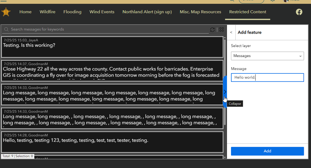

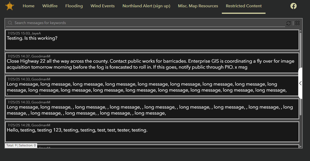

Matt-Goodman
Thanks for confirming. I ended up setting up a basic hosted table with edit-tracking fields, shared to the appropriate permissions group in ArcGIS Online, then using it in a super-simple Experience Builder app that includes an 'edit widget' in a collapsing panel. I wish it a was a little more configurable, but it sort-of does the job.
