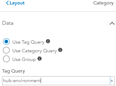

We are trying to use tags to control access to data in a hub site. We have devised very specific tags and added them to content. I am not sure, but I think the search is a little to 'broad.' What I mean is if I enter the tag 'hub-environmental' as a search criteria, I think it returns all content that has the word 'hub' OR 'environment' in its tags and lists too much data.
Is this the case? Is there a way to enforce strict tag-discipline so that the data comes up only if it has a tag that is identical to the one entered?

For me tags are, by design, meant to be broad and therefore should not be "strict" - they are there to return just as the example you've given. I would manage categories data returns by group or category. Alternatively, create search results as you wish to see them, take the url, publish it into AGOL as content, then use a card. But really, I'd just control this by groups or categories.
My own example; I've organisational data that I make available within an internal data catalogue and our open data site, I manage its visibility at group level, publishing to internal and external groups, and have three attached categories.

Thanks for the info. I think I see how it's working. I had a situation where the title of an item included both words, so in this case 'Hub' and 'Environment' and the title was applied to tags by default. I think I can avoid this but tweaking tags when unwanted things show up. I started by using groups, but there was concern they'd be hard to track. Looks like whatever we decide on will create a tracking-challenge 🙂
