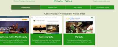

Hello,
I customized these three cards on this page with CSS: https://trees-lacounty.hub.arcgis.com/pages/tools-&-resources#related_sites. Although they are no longered centered. What CSS styling can I use to re-center it?
-Brandon

Is this in a gallery? I would add spacer cards on either side of the gallery. The width of the spacer can be adjusted by hovering over the side and clicking the arrow. Note that spacer cards have the option to be ignored for mobile devices.
KlaraSchmitt
If you're okay with those cards being slightly wider, you could also remove the 'col-lg-3' in your code, which would mean that the medium breakpoint of 3 cards, 4 columns wide (col-md-4) would apply to these and they'd stretch to fill the space of the 12-column grid.
croush2024
In case it is helpful, I'll mention that I have centered three buttons with code that starts with:
<div class="row" style="text-align:center">
<div class="col-xs-12 col-sm-4">...
Your page is quite a bit more complex, so I'm not sure to which div to apply text-align:center or whether you might need a new div layer if using this method.
BrianRollison
Hi @BrandonPrice1 - you could also consider in-line CSS layout such as flexbox to accomplish this. As a suggestion, you might consider using the Gallery Card for this instead (you are directly above this section). You can register exterior domains, such as https://www.cnps.org/, as Document Link item types. You can add a thumbnail, summary, etc. to make it look nice within the Gallery Card.
