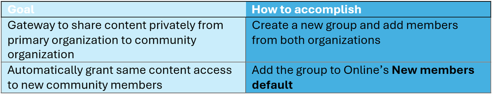

Quick recap
Here’s a helpful table for a summary takeaway.
IkechukwuChristianEzeofor_4-1761871381194.pngIkechukwuChristianEzeofor_4-1761871381194.png
