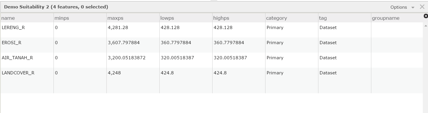

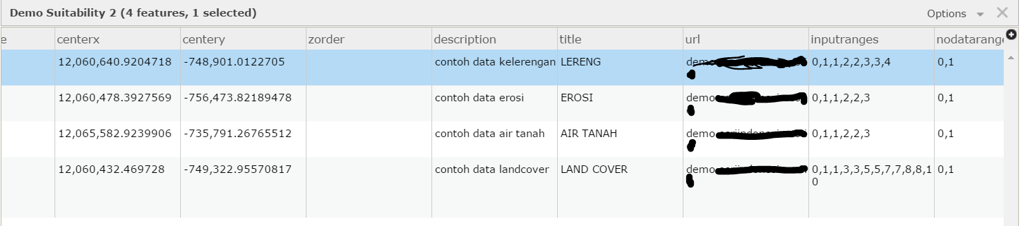

Hi Lusi,
Would you be able to provide a screen shot of your mosaic dataset's attribute table?  Would like to see what values you have populated for each of these fields.
LusiSuwandi
Deactivated User
Hi jskinner-esristaff, please see the screenshots below
