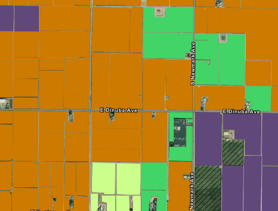

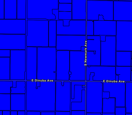

Hello,
I am finding that when I bring in any newly published Hosted Feature Layers into Geoplanner that have some kind of attribute symbology, I do not see the symbology - actually, I don't see the layer at all (I have to click 'layer symbology' and assign a color for all the polygons).  I notice this with any layer I have published sometime after July, 2023 .  Anything I've published in July, or earlier, the symbology shows up fine, but not so with ones I've published in August onward (see images below).  I am wondering if this has to do with updates to either Geoplanner, ArcGIS Online, or both?
I am publishing from ArcGIS Pro 3.1.3.  Using Geoplanner version 3.8, Build 144
Crop data published July 7, 2023
Crop data published August 27, 2023

Okay, problem solved!  I found the solution on a different thread (see below).  While publishing from ArcGIS Pro, you just need to check the "Use symbol types compatible with all clients" box under the 'Configuration' section.
