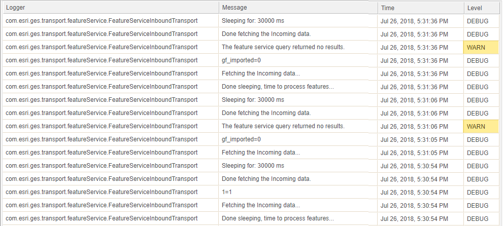

In this case the DEBUG logs for the FeatureServiceInboundTransport were a little help. Here's a snapshot; setting the logging to DEBUG for only the one logger made it reasonable to use the GeoEvent Manager's log viewer:
GeoEvent Log Messages
What I did for the test was leave the input's default query expression set to 1=1 to confirm that feature records were being polled. Then I changed the query expression to look for only records whose gf_imported attribute was equal to zero, so that I could see the warning that the query expression excluded all available features.
