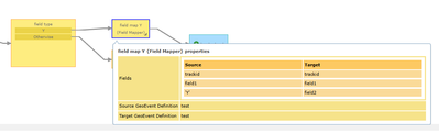

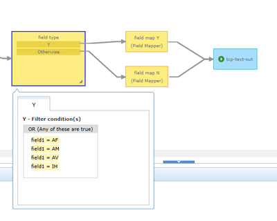

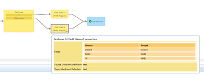

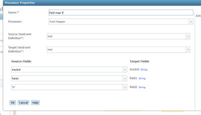

I know this is an older thread, but have you tried a Choice Element?  You could setup a choice with "field1 = 'AF' or field1 = 'AM' or field1 = 'AV'  or field1 = 'IH'", then follow with a field mapper that hard codes field2 as 'Y'.  In your choice element enable the "Otherwise" option, then follow with a field mapper that hard codes field2 as 'N'.  Finally merge the flows together for your output.
