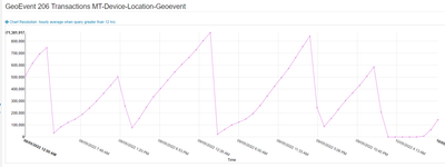

Num. of transation past week.

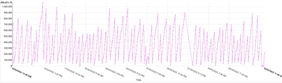

Num of transactions past month.
Geoevent is constanly building up and falling down for no aparent reason.
Could it be that the number of users connecting to the stream service are not being handled properly by Geoevent (like not unsubscribing users properly in the background) and this makes the Geoevent to consume more and more resources until it crashes?
Can you offer any explanation of why this is happening?
