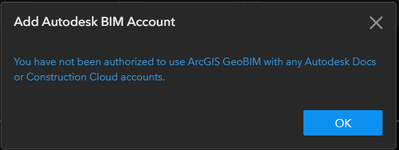

Hello,
We are very eager to get started with GeoBIM, as some of our contacts are.
We both have the same problem however, we cannot add an Autodesk BIM account in GeoBIM as we are not authorised, see the error message below. We are administrator in BIM360.
I guess it's a simple setting in BIM360 we need to change, could you tell us how @Anonymous User ?
Thanks a lot!

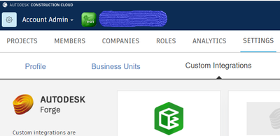

Hi Stephen, Thank you for your reply.
Unfortunately I cannot find these settings anywhere that are mentioned in the Autodesk link. The settings tab is missing, please see attached printscreen. Am I missing something or using an old version?
Thanks for you help.
StephenBrockwell
Unfortunately, you are signed in with Project Admin privileges. You have to have Account Admin privileges to do this.
If you have Account Admin privileges, the Account Admin tool would appear on the drop down menu where you currently have Project Admin showing.

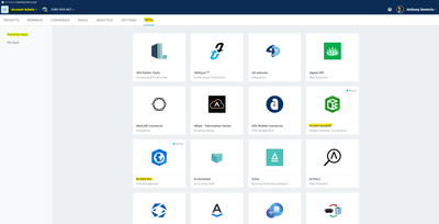

I have two accounts for Autodesk Docs    In GeoBIM when I go to add an account I only see one ( the wrong one )   Any idea what is going wrong ?
by Anonymous User
Not applicable
Hi @ChuckPietra , do you know if the ArcGIS GeoBIM integration has been enabled on both of those Autodesk Docs accounts? Since these are two separate instances of the overall organizations that will be managing multiple sets of projects within each, the orgs need to have the app integration enabled on each. For example, we have a BIM 360 account and an Autodesk Construction Cloud account; each of these need to have the GeoBIM app enabled like in the screenshot below. Note: this also needs to be done for any other of our ArcGIS integrations too like the ArcGIS Pro or Site Scan integrations to Autodesk.
