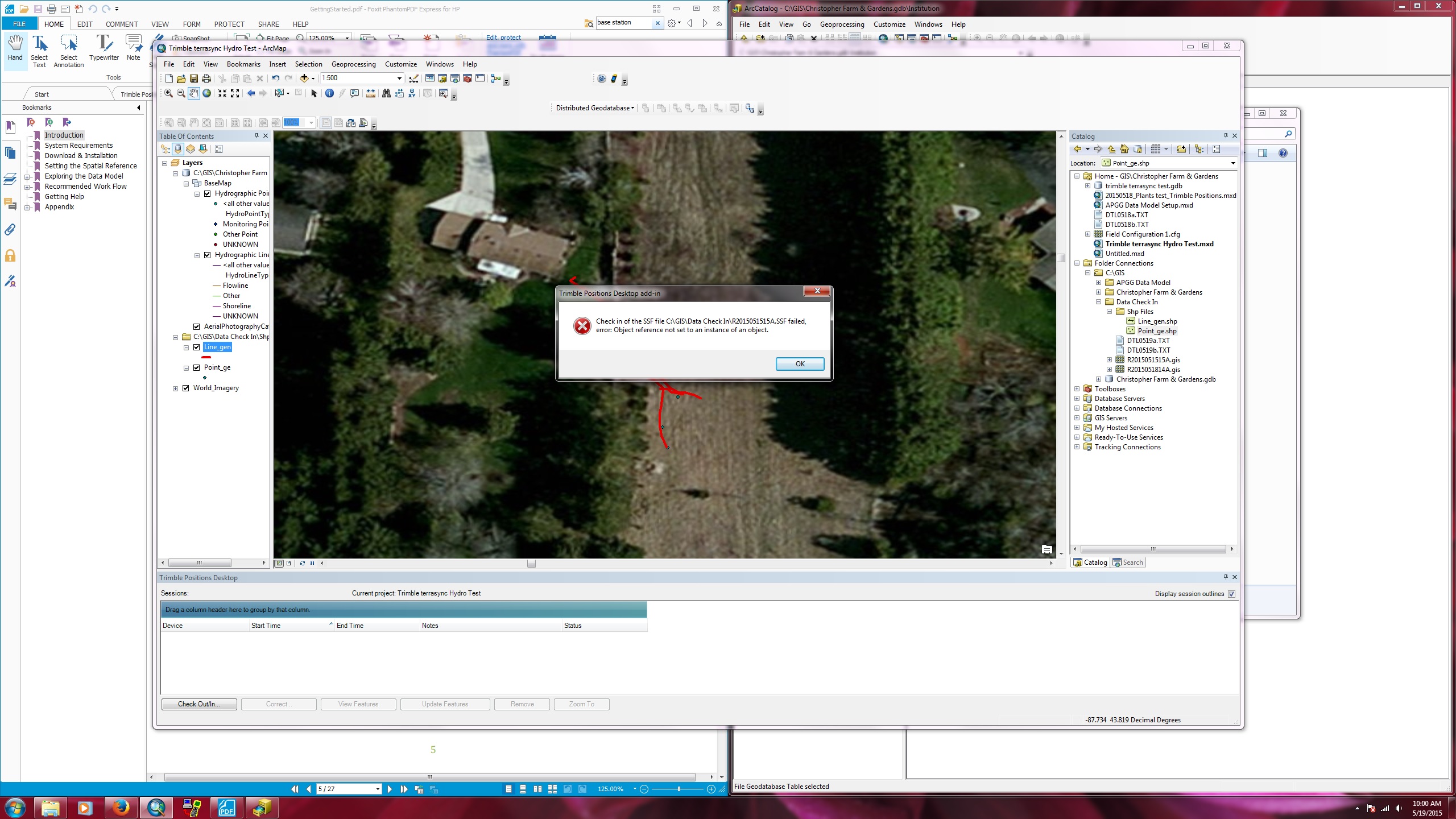

Good morning everyone...I just got everything setup with Trimble positions Desktop Add-in. I have ArcGIS 10.3 ad use TerraSync in the field on out Trimble Geo7X.
First issue is that I do not see the "GNSS enabling" option in the Desktop Administration dialog. This one has me pretty stumped
Second, I am having trouble Checking-in data collected using the generic TerraSync feature classes. I collected these data last week, prior to having our new workstation and the software. Please see the attached screenshot for the error I get when trying to check-in any SSF using the generic TerraSync features.
I can export those data to SHP files and get those opened in ArcMap, but then I am unable to correct them.....I was able to export some schema from our data model to TerraSync, and collect field data with those attributes, then check those in and successfully correct them (sort of - see #3).
Third, when I corrected the data from the test file, I was only able to select one base station, and it did not give me enough accuracy (based on what the unit was expecting). What is the best way to setup Trimble Positions for differential corrections? And, does this have something to do with not having the GNSS Enabling option?

Hi Miles,
The latest version of the Trimble Positions Desktop Add-in does not have that GNSS Enabling button anymore in the admin window. That is really only required when using the ArcGIS for Windows Mobile field software, so it was removed on purpose to try to resolve some of that confusion. If you set up a project for ArcGIS for Windows Mobile, then you will see the GNSS Enabling option in there.
On your check-in, it sounds like maybe you were collecting data in ArcPad and then trying to bring it in with the TerraSync tools? Or maybe that you had collected data in TerraSync that was just created on the handheld and not created from Positions? That won’t work to check in. In order to check in TerraSync data to Positions, it has to be checked out from Positions. If you were using ArcPad, you could use the QuickProject check-in instead.
And yes, Positions does not allow differential correction with multiple base stations the way you could in Pathfinder Office. You will only be able to correct against one base station at a time.
Hope that helps.

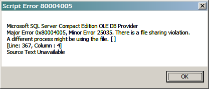

Hello all...
I have a new question.
I am trying to use Quick Fields, for the first time.  I have exported a project with a point feature class for use with ArcPad.  I have opened the project in ArcPad on my pc in order to create a Quick Field that adds a sequential ID.  I have turned on Quick Fields.  I have gone into Design Mode.  I click on the Quick Fields button and then click on the Add button.
Here is where I have a problem:
When I choose "Layer," I get this error...
I have tried closing every program on my computer except for ArcPad and I still get this error.  Could this be because I am using a personal geodatabase instead of a file geodatabase?
I'm afraid I don't understand what this error means.
Any help would be appreciated.
