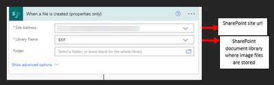

When creating the flow, I will set it up as an “Automated cloud flow” since we would like the flow to trigger automatically when new files are uploaded to the document library in SharePoint.
The first action (When a file is created (properties only)) is the flow’s trigger.

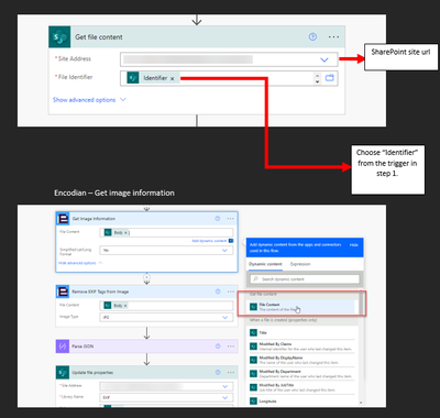

In the “Encodian Flowr” action – Get image information, choose “File content” from the previous action (Get file content) and choose “Yes” for Simplified Lat/Long Format. This action will get all the image information of the files uploaded in the document library (doc library name: “EXIF”).
The “Encodian Flowr” action – “Remove EXIF tags from image”, extracts the EXIF properties from the uploaded image files which can be used to update the file properties in the subsequent SharePoint action “Update file properties”. Populate “File content” with the  “File content” from the previous action (Get file content). The files I will be uploading are of type “JPG” which needs to be specified in the “Image type”.

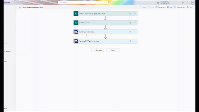

The EXIF properties in the JPG files are stored in JSON format. Therefore, I will need to use the built-in action “Parse JSON” to parse the JSON output, which can then be used to update the file properties in the SharePoint document library.
“Save” the flow and run a “Test” to see if the “Get Image file” generates the EXIF data JSON.
In the “Parse JSON” action, use the “EXIF Data (JSON)” from the “Get Image information” action
Click on “Generate from Sample” and paste the JSON output from “Get image information” action as shown in the screen capture video. Click on “Done”
