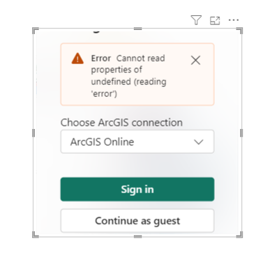

5. I added a new ArcGIS visual to the ,pbix file and then pressed the Sign In button
6.  The following error message was displayed
 I have X and Y points in my PBI data so I loaded the data in and tried to login again, only to find myself back at step 3 again.

Why did I get an error message at step 6?

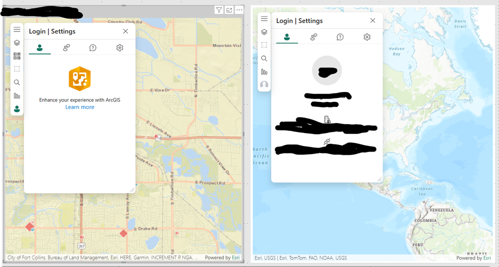

I have the same bug, and it happens if I've sat on a report for a week (doing other things), and get logged out.
I can create a new visual and login, but I cannot login with my existing visuals.
See?
This is a really obnoxious bug for me. The only workaround is to delete the logged-out visuals and recreate them. It costs me a lot of work. And then, I can only work on that visual for a week before it gets logged out and I'm locked out and have to do it all again.
