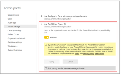

I believe there is a tenant administration setting/option that allows/disallows usage of ArcGIS for Power BI for the entire organization. I think this setting is perhaps not toggled on for your organization.
It should be something like the below, although, the screenshot/UI may be slightly outdated:

Thank you @AlagiriVenkatachal. I will look into this with my MS Entra admin.
note:
Admin for the ms tenant must also have a licensed Power BI to enable the setting as shown above.
