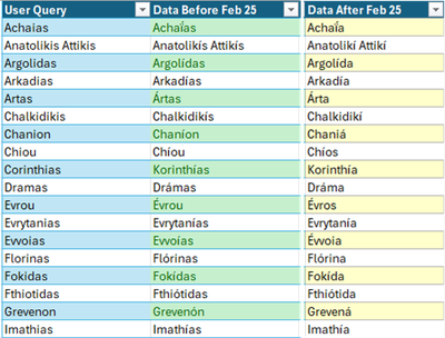

After working together with the responsible team, we found that during the Feburary 2025 update, the names for the Subregions where updated as part of a data update by our data provider. Hence, the boundaries were failing to be drawn on the map for Greek prefectures for your dataset.
Please find below a sample dataset that illustrates how the names changed after the data update. Also, attached in a Excel sheet containing the new names that is expected after the data update:
Once again, I apologize for the inconvenience. Please let me know if this resolves your issue.

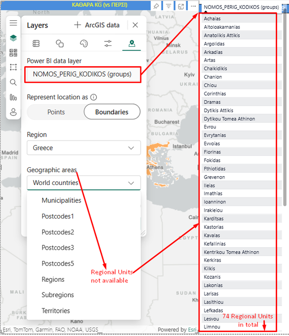

I confirm that after your last update (2024.2.560), Greek "Regional units" (perifereiakes enotites) are not available at the "Geographic areas" drop down list:

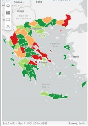

When the Greek "Regional units" were available (until end of February 2025), Greece operating map was like the one below:

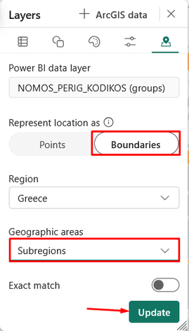

For your info, I would like to show you how the Greece map is displayed, when I change the "Geographic areas" to "Subregions":

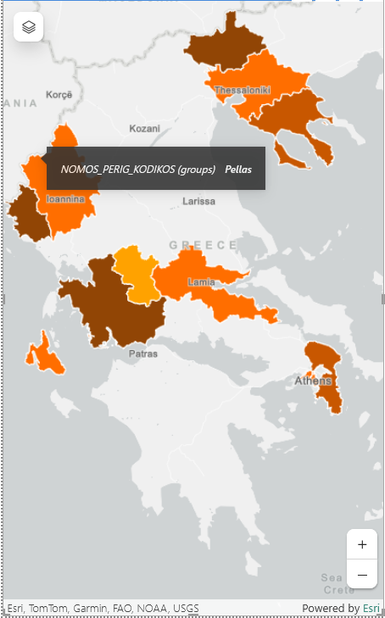

Unfortunately, only 10 (out of 75 in total) "subregions" (perifereiakes enotites) are displayed.
Nine of them show the correct polygon boundaries and only one is displayed as "Pellas" (pls look at the tooltip below) instead of the correct polygon boundaries of "Ioanninon" subregion:
In conclusion, it is certain from the above facts that the "Subregions" are not just the renamed "Regional units".
Data was changed or is now missing from this feature, so we are waiting for your feedback.
akaradimas
Hello @AlagiriVenkatachal,
By using your attached Excel sheet I managed to draw on the map all the Greek Subregions (perifereiakes enotites) of our dataset.
Thank you so much for your help. I really appreciate it.
