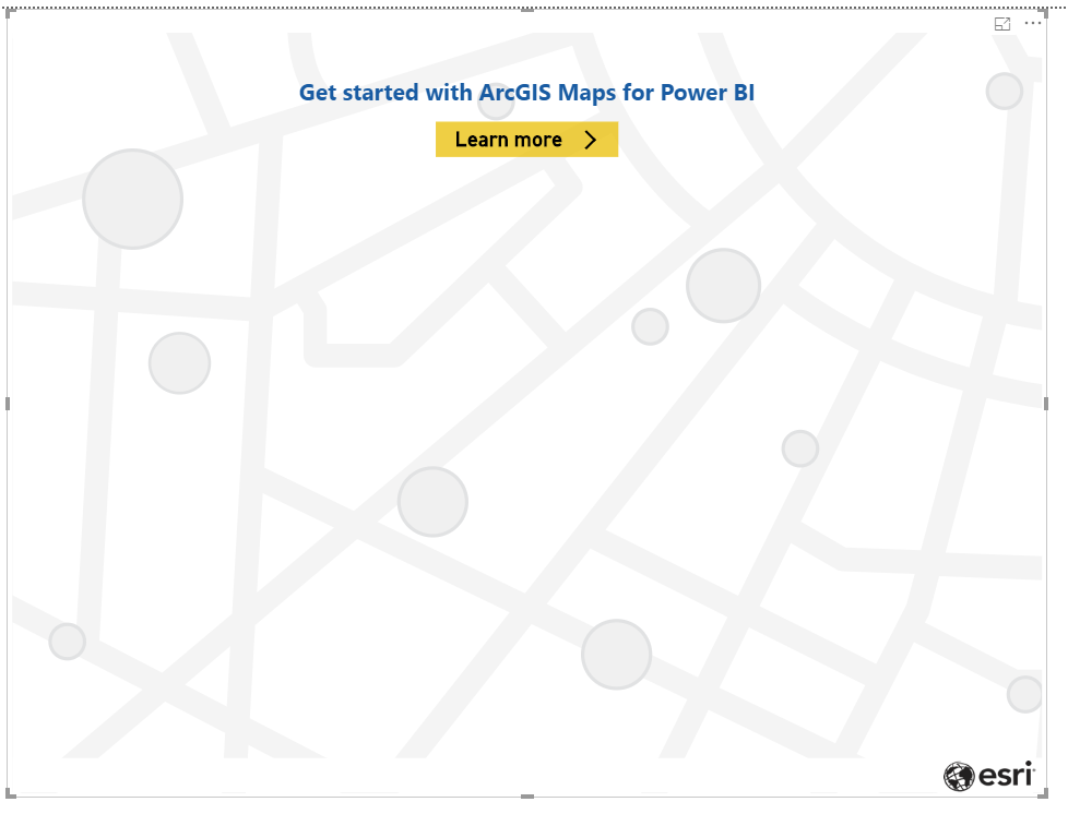

I see the ArcGIS maps visual in the Power BI service and I can add it to a report, but then there is no option to sign into ArcGIS Online. Anyone experienced this?
601
08-06-2019 10:16 AM
LeighDemers
This is all I see when I add the visual.

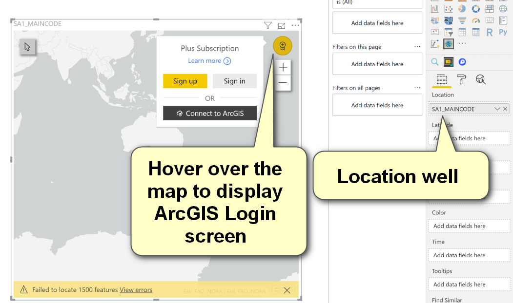

StevenDoherty
I could be wrong but, if you put something in the "Location" well the login will appear as per below.
Hope this helps.
