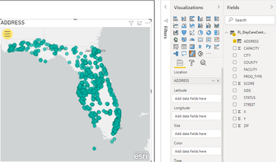

I have done an example below, where my Shapefile had the address of the points split into a few different fields. I needed to create a new column with these attributes combined in order to display the location.
You can do that too by following this article - Create a separate Location column in your data

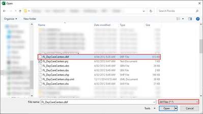

  1. Open MS Excel
  2. Open the .dbf file of your Shapefile. You might need to select "All Files" from the file explorer. You can then save the file as a .csvImportDBFtoExcel.pngConvertDBFtoCSV.png
  3. Open PowerBI Desktop, then add the ArcGIS Maps for PowerBI Visualization and sign in with your account.
  4. From the Get data tool, connect to Text/CSV then navigate to your new .csv file and load the data.
  5. Drag your location column (or create your own) into the Location field
Voilà!
Your Shapefile data is now displayed in ArcGIS Maps for PowerBI. This method works well with point address data, or polygon data that is using locations such as zip codes, postcodes or administrative boundaries.
