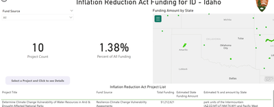

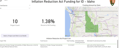

I am also experiencing issues with the drill-through. Here is an example I can share as I have the same issue. I start on a map where the viewer selects a state to see funding data.
I have selected Idaho, for this example.
Using the Bing map visual, the map zooms to the selected state:
Using the ArcGIS Map with a public NPS park layer added the map does not automatically go to the state that was selected. If the user interacts with the page slicer or table, then the map will update, but it frequently takes several interactions before the map will update:
Here is what the map looks like after several interactions and what the expectation is for what it should look like upon drill-through without having to interact:
