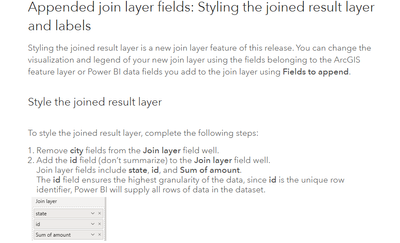

I was able to symbolize based on a joined field by following the steps toward the bottom of this blog article. Will this work for you?
OriGudes230175
Thanks  @GBacon
Which section you are referring to? Appended join layer fields: Styling the joined result layer and labels?
How this is different, I am not sure I am clearly undersetting this?
Ori
GBacon
Yes, that is the section I was referring to in answer to your question "Is there a way to enable symbology in ArcGIS Maps for Power BI based on joined fields..."
Maybe your situation is different than this scenario or your field just isn't showing up the Fields to append dropdown? If that is the case, your field needs to be added to the Join Layer field well to become available to the Fields to append list.
