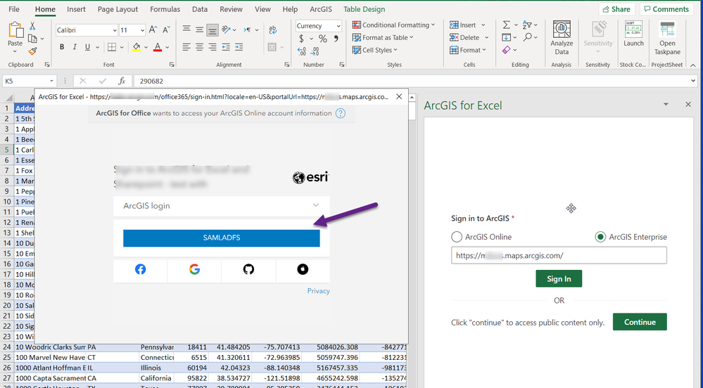

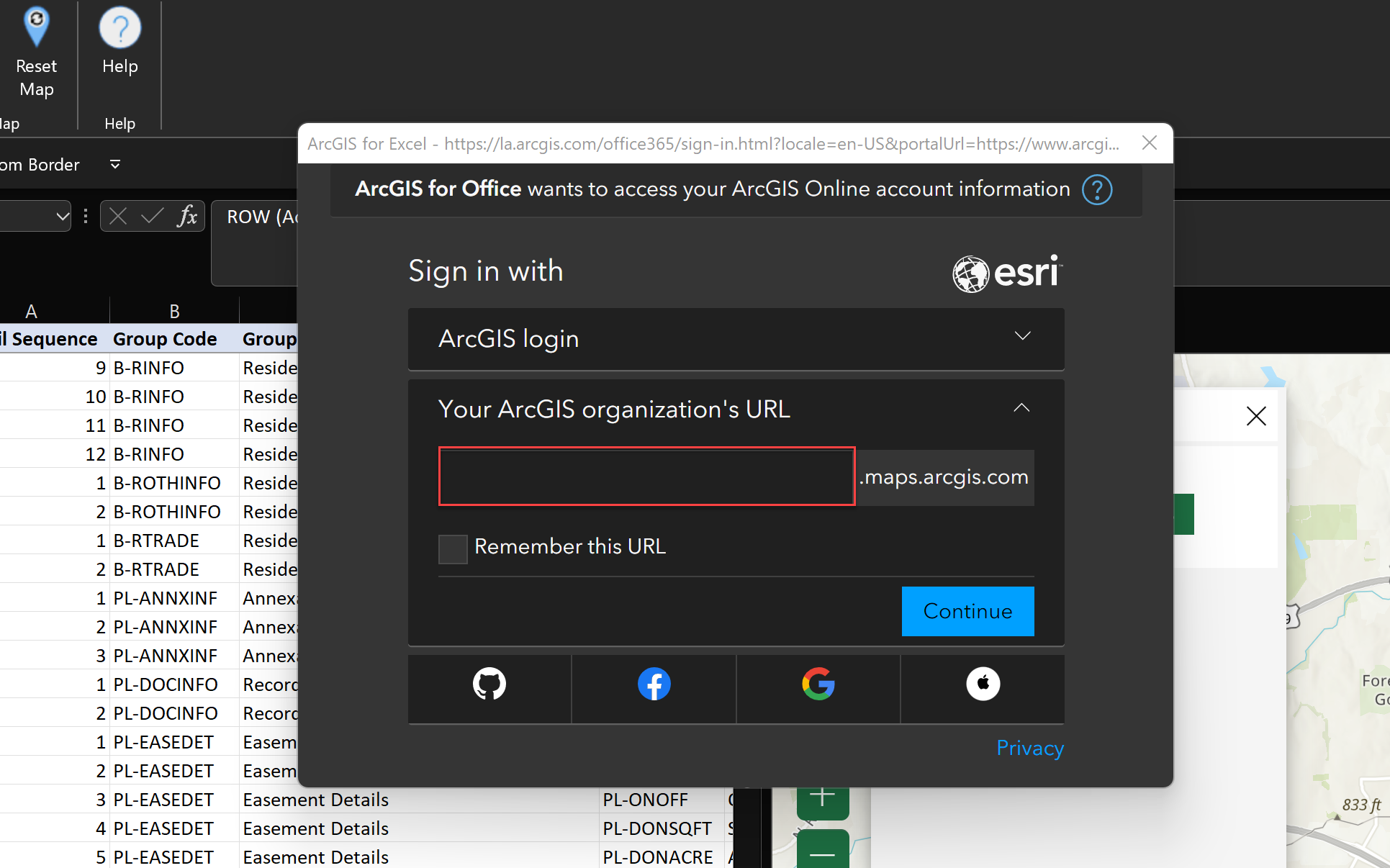

Loving the new ArcGIS for Excel so far. I am however, running into the same issue with user after user in my organization. When prompted to sign in, they don't know what our organization URL is:

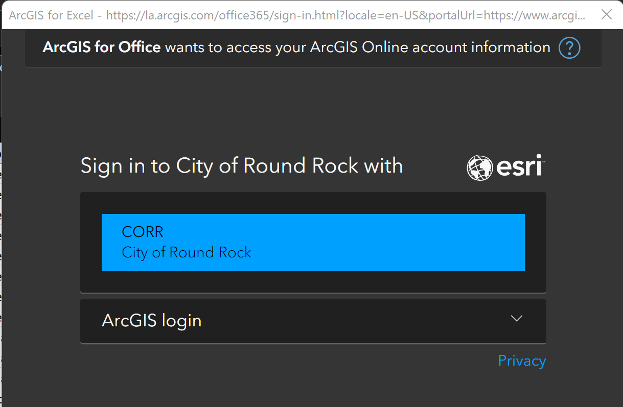

As an administrator, I am able to pre-configure this URL in other ArcGIS products so that when users attempt to sign-in, they see this and can simply click the big blue button:
Is it possible to do the same in ArcGIS for Excel? Being able to configure this for my organization is critical in helping all of our users get up and running faster.
