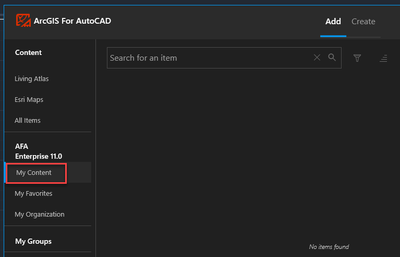

When the user is on the Add Data UI and signed in what can they see when they select "My Organization" under the ArcGIS Organization? If the user does not own any content the user will not have any layers listed on the "My Content" tab.

My user does not own any content so this page should be blank as it is:

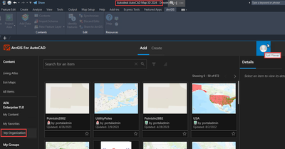

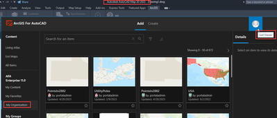

I appreciate the continued testing. I just finished testing AutoCAD Map 3D 2023 and 2024 and both work fine for me.
2023 with justViewer user
2024 with justViewer user
