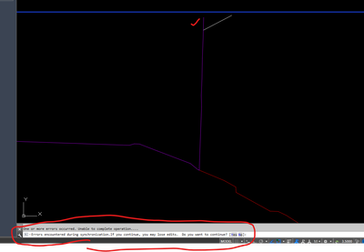

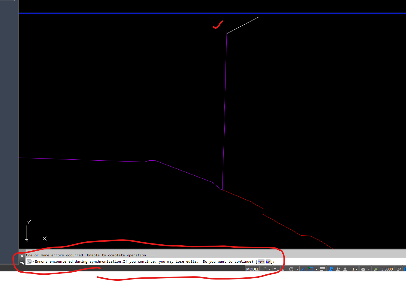

Using ArcGIS for AutoCAD 400 and getting an error message when performing a synchronize command for a line feature class. Did a simple line stretch and the error occurs.
Please provide details on what can be causing this problem

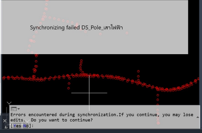

@Hello @DanWade
I've encounterd the same problem when trying to synchronize the features.
However, I've already installed ArcGIS for AutoCAD version 410
And when I answered "Yes" to pursue the synchronize, the new feature I created were disappeared.
It seems like nothing have synchronized.

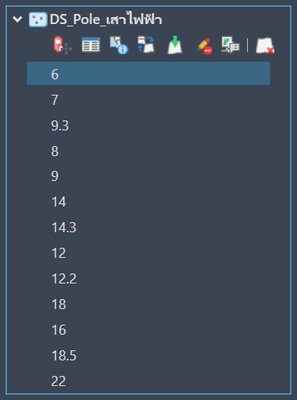

1.Autodesk AutoCAD Map 3D 2022
2.It's feature service from ArcGIS Enterprise Geodatabase 10.8.1 which is added to AutoCAD by URL.
3.I'll let the technical team check on it later.
4.English version
5.It has subtypes but doesn't have any special characters
6.Yes, it works fine with GIS
7.I've already upgarded to 410 now, so I cannot test on that.
