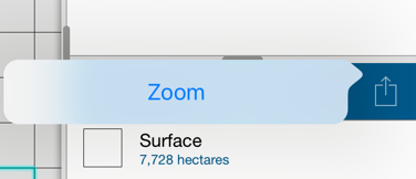

Thanks for your reply. Here is the button I am talking about:
Thanks for the trick of the edit tool but it would not work on readonly feature

@NicolasGIS sorry, i can't workout where this is in the UI. Are you using Collector Classic, or the latest version? And iOS or Android?

NicolasGIS
Honored Contributor
It's classic. Did not have the time to test the new Collector that ArcGIS Field Maps was already out 🙂
Snapshot is from IOS but it's available on both IOS and android once you have an entity/feature selected.
On IOS there is a rectangle with an arrow to have more option.
On android, it's a small triangle at the bottom right corner

Ahhh I see. I haven't used Classic for a few years so had to reinstall and have found it. Yes that isn't available in Collector or Field Maps. So i would add an idea to the community and get some upvotes.
