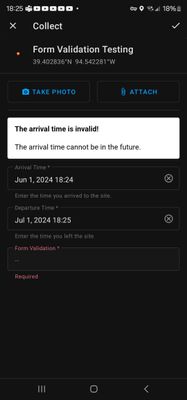

A user enters data into field x that we consider to be invalid for one reason or another.  The required validation field calculates to null, indicating the form is now invalid and thus will actively prevent the user from submitting their form (if they try it will say 1 attribute failed).  Now, this works, but isn't really enough, as the user at this point has no idea what is wrong.  This is where the new info elements come into play.  For each condition we have in the validation field's calculation we add an info element whose visibility expression is also tied to that condition.  So if field x's value should contain a period at position 9 and be followed by at least 4 numbers, but isn't the info element would be visible, the validation field would be null, and the user would not be able to submit the form.  As soon as field x met that condition, the info element would disappear, the validation field would have a value ('Form is Valid' or similar), and the user would be able to submit the form.

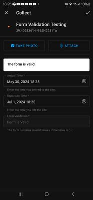

For you scenario, it might look like the following.  Here we have 3 info elements at the top of the form, each is conditionally visible.  We have your two date fields, that are required and the form validation field that is required and calculated, returning null if invalid to prevent form submission and returning 'Form is Valid' to allow form submission.
Expression Details Below:

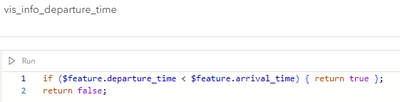

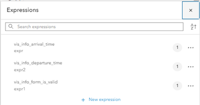

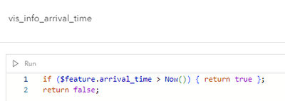

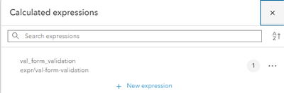

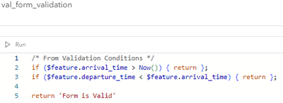

The example above has 3 Visibility Expressions (1 for each Info Element) and 1 Value Expression (for the form validation field).
The following return true (is visible) if the field is not valid otherwise returns false (not visible).
The following returns false (not visible) if form validation field is null (any condition not valid) otherwise returns true (visible).
The following value expressions returns null if a some condition indicates not valid, otherwise return a string 'Form is Valid' indicating none of the invalid scenarios were met.

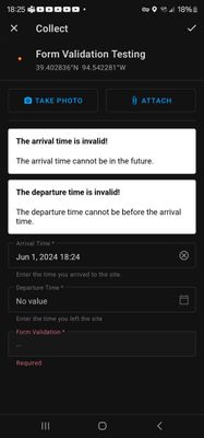

And Field Maps result looks like the following:
Hope this helps!

Thanks @JustinReynolds ! That works wonderfully! Its a shame that validation isn't supported yet, but hopefully it will be soon.
It took me a minute to realize the info elements you mentioned are only available in FieldMaps Designer and not in the form editor in the map viewer. But once there it was easy to set everything up like you described and it works great in our mobile maps.
Have a great day!
