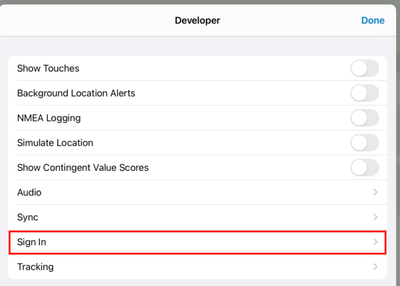

AliciaShyu
Our organization also uses shared iPads, and periodically we'll borrow iPads from other departments.
We stumble on this solution but it only works for Field Maps on iPads. We don't have android devices, so not sure if it works on Android. If someone has a solution for QuickCapture, please let me know.

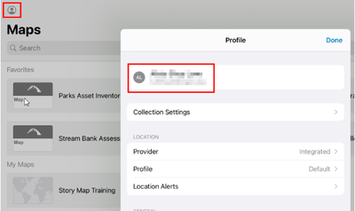

  • Login to FieldMaps
  • Open the User Profile window
  • Tap 3 times on the user icon
  • Select "Sign in"
  • Select "OAuth"
  • Change to "In App"
  • Sign out of FieldMaps

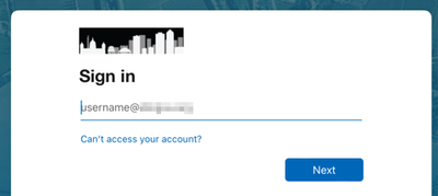

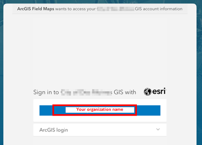

  • Sign back in, this time you'll get multiple login windows where you'll type in your user name and password
Hope this works for you. If anyone knows how to do this in QuickCapture, please don't gatekeep!
