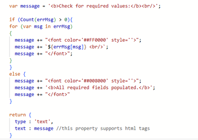

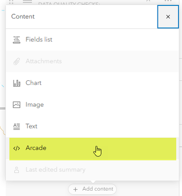

DougBrowning
MVP Esteemed Contributor
Thanks the user ended up changing to an Arcade box and doing all HTML which works in both.
