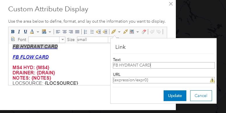

Updating and solving the thread. Chris gave me a few more ideas, and using custom attribute displays worked for me. Using the iOS applink at the beginning in the arcade expression, in my case "filebrowserpro", and then creating a URL in the attribute display now opens up my images in the desired app.

BrendonJoyce1
Hi Chris, I have attached a few images below showing how the link fields are configured. The things removed are just my portal org specific things. Also included is the FileBrowser app link that if copied and pasted into Safari, will prompt to open in the FileBrowser app, sort of like how we'd want it to do from Field Maps.
