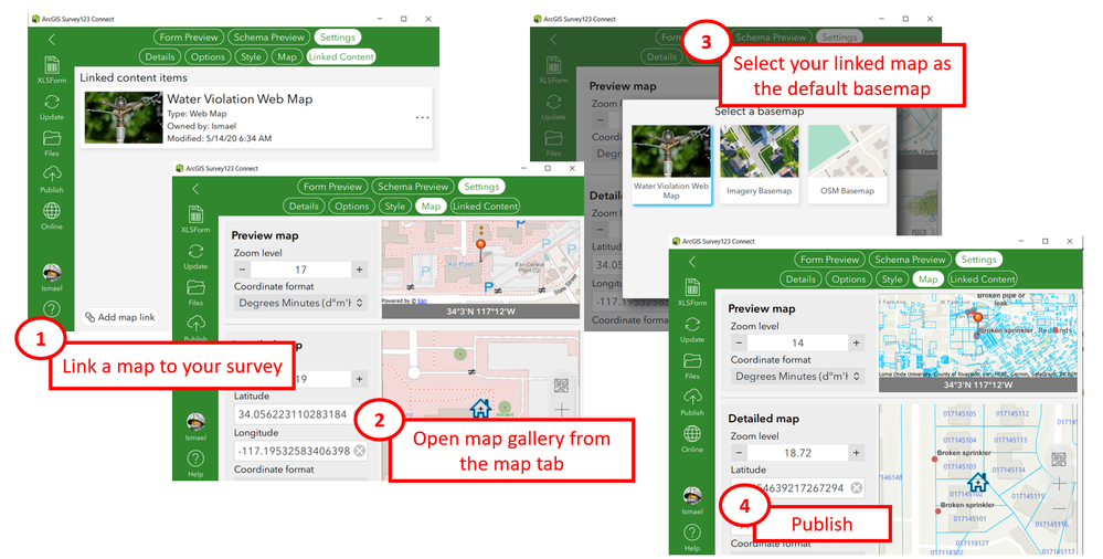

I am guessing the reference points is to provide context for visualization on a map (i.e. no interactions, just display as a basemap). Survey123 does support adding custom data/layers into a map by linking maps.
Source: https://community.esri.com/t5/arcgis-survey123-blog/survey123-tricks-of-the-trade-configuring-survey/ba-p/897815Source: https://community.esri.com/t5/arcgis-survey123-blog/survey123-tricks-of-the-trade-configuring-survey/ba-p/897815
I believe this post by @IsmaelChivite  would be useful in going in more details.
Please see if combining the workflow above with Survey123's constraints in my previous post, would work for you.
