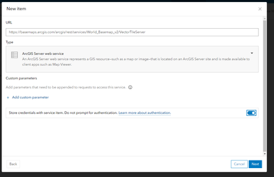

I've logged into my AGOL Org, found the esri basemap, copied the URL, gone over to our Portal, added a new item, put in that basemap URL, and checked the "store credentials" for the item but when it asks for the username and password, nothing I put in works.  I have a built-in named user account in our AGOL org and that isn't working.

As I understand it a named user account must authenticate the basemap layers using their ARCGIS Online account in portal.
1) Navigate to the layer you want (World Topographic Map - Overview (arcgis.com).
2) Then copy the rest endpoint.
3) Log into your enterprise portal.
4) Go to content and add "new item"
5) paste the rest url and then use your arcgis online named username and password to authenticate on the next page.

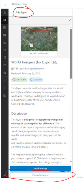

Couple of tips. If you have a project that already works, but you need a special basemap (or more than one basemap) you can go to the "add layers" and start to add it as a layer. When you click anywhere on the layer (but not the plus button). This will allow you to see the option to choose "Use as basemap". This will then replace your existing basemap. You can add other imagery in as layers in the map that will work for export as well as long as they are configured property.
