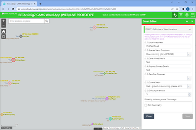

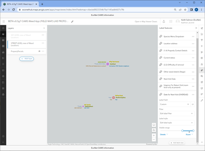

KeithSalmon
Hi all
Our environmental trust has an app where we have seven labels set up for two layers in a Field Map which look fine in the new map editor AND when viewed from a Web App.
They used to look fine when viewed from the Field Map app from my phone or iPad - then suddenly the stopped showing for one of the layers but still show for the other layer.
I've been through all the settings in the field map editor and other areas - but haven't found a trick to make them appear on the phone again.  Would welcome some help - we are due to go live next week!
Some screenshots below.
I tried the suggestion of using the Visualisation panel to get around the problem - but I couldn't see how it would help.
Thanks Keith
PS here's what the labels look like in the Field Map editor:
And here's what the labels look like in a Web App:

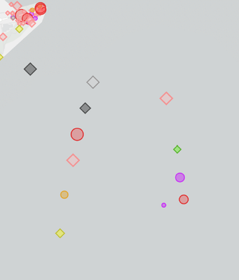

Here's a screenshot of part of the map running on the Field Maps app on an iPad (no labels showing)
