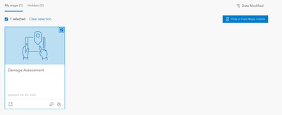

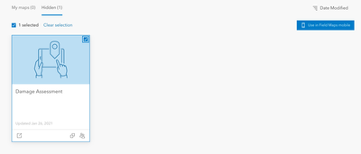

For the hiding/showing in Field Maps there is button as shown in this screenshot that appears when you have selected a visible or hidden map.
