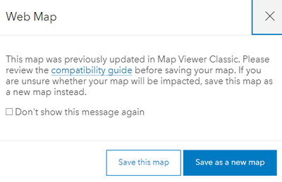

I am a little aghast at that response. Disabling the warning message does not make the issue go away. It keeps the issue but you just don't see it.

No the issue persists in Edge.
This time I selected Save this Map.
My changes to Configure did stick
However, after saving a change to Configure it had reverted again to a Classic Map.
I saved it again and opened it again and it had not reverted to Classic
I will speculate at this point that something may be broken with forms

You are encountering a bug in the Map Viewer. The logic it uses to determine whether the web map was authored in Map Viewer Classic is wrong and is the root cause of the issue.  This is a bug and one that will be addressed in a future release of Enterprise.  Until then, there's two paths forward for you.
  • Request a Hot Fix for this issue through Tech Support or your Account Manager
  • Check the "Don't show this message again" checkbox
You mention in the last post that "However, after saving a change to Configure it had reverted again to a Classic Map." how are you determining the map is a "Classic Map"?

I am determining it reverted to classic map because the error message comes up again saying it was created in Classic.
But only after making an  update in the Configure for Field Maps

The issue and bug isn't with Field Maps or forms or form authoring.  The bug is in the Map Viewer and its check in how it determines whether to display the message or not. So, while the message is indicating the map is authored from Map Viewer Classic, the map is not.
The workaround for this is to check the checkbox at the bottom of the dialog. You will not see that message, as I mentioned before, this is a per browser setting, so if you use a different browser, you have to check the message again.
I do apologize for the issues you're having.  You can escalate these bugs to Tech Support or your Account Manager, that includes the issue with Dashboard that you noted, as request a Hot Fix be considered.
