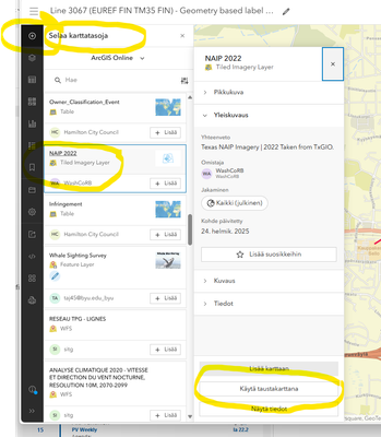

So are you saying that just opening any Local State data and using that as a basemap does not work? I can not help much on that as In Finland I have no Local State projection but this is the process I use with local files here. So I do not click the add data but I rather open the data dialog and there instead of opening it I just click use as a basemap option. I agree that getting your own data might be a bit hard as basemap should be some defined layer type. Not all feature layers can act as a basemap.
My screenshots are in Finnish language but you should find right clicks by following ones rounded with yellow. That path leads you to but some Tile Image layer as a basemap. This is how I have done it.
