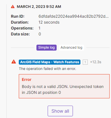

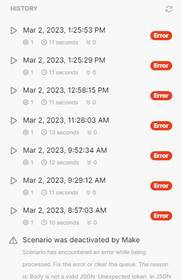

Make (formerly Integromat) scenario with ArcGIS Field Maps module was working fine yesterday, today I keep getting "The operation failed with an error. Body is not a valid JSON. Unexpected token in JSON at position 0". Haven't made any changes to the scenario since it was set up. I tried reauthorizing the connection but that didn't help. Anyone have similar issues? Any thoughts on how to resolve while retaining queued data?

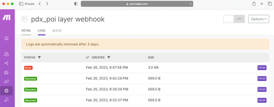

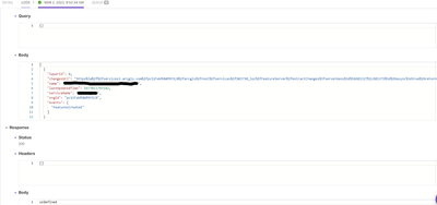

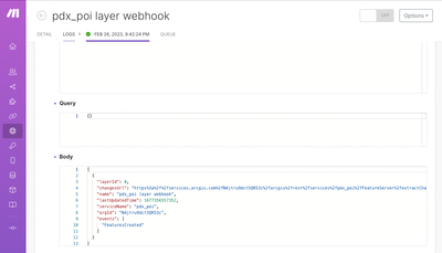

In Make, under the Webhooks section you can look at the Logs tab and see details about each time the hook was triggered (similar to the images below).  What does the Body of the requests that are failing look like?

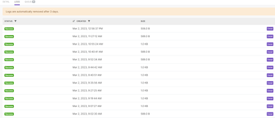

Thanks @JustinColville ,
The logs under the Webhook section display 'Success' under Status.
but in the Scenario, it shows the error.

Are you able to run an extractChanges REST API call in a browser similar to changeURL in the Body of the 9:52am webhook?  Does that complete successfully and return valid JSON?
