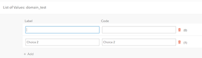

MitchellGrafstein
I was able to enter a string with one space to the codedValue domain and that was sufficient enough to fullfill the required field requirements.  Not ideal, but that did work for me.  Disappointing that we cannot use an empty string as a default value, but ' ' worked for me.
Oddly enough, I do have one feature saved with the ' ' value, and it looks like the web app couldn't count it even though it definitely exists as a single space in the data.  (Should be a (1) next to that first option.) [This is in Enterprise Portal 10.9.1, so it could be different in AGOL.]

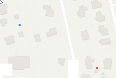

MitchellGrafstein
Just as an FYI, it still cannot "count" it correctly even in the visualization tab, but it does show up correctly in Field Maps.  (In my test, I have one blue dot and one red dot.  The single space string is erroneously showing up as other here, but it shows up correctly in the mobile application.)
Probably a bug, so I am curious how it shows up for you in AGOL.  I have had issues counting up null and blank values in Arcade in the past, as well.  I might have to submit a bug report on these types of things at some point.
