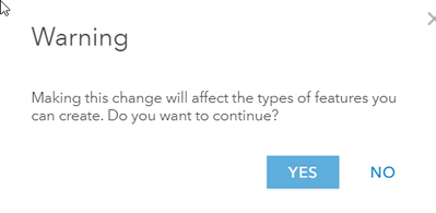

You can alter the Feature Templates from Field Maps Designer.  You can also alter the Types by opening up a feature service and clicking on the "Visualization" tab, then adjusting which field you are symbolizing off of.  It will give you a warning when you make this change that it will affect the type of features you can create. (See screenshot below.)

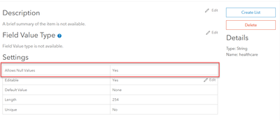

Go to the Data tab of the Item Details for your layer. Check that field and see if null values are allowed. If it is set to No then Field Maps will make it required because the record cannot be submitted without a value for that field.

Thank you for your reply. I did look at this before, and yes null values are allowed and it looks just like your screen shot. I can also leave the field blank just fine in map viewer, but not in field maps.
Edit: it's also not showing as required in the field maps designer so I'm just completely at a loss here
