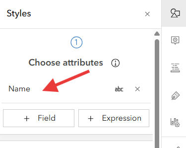

No problem, you just need to choose a different field (like common name) to base the templates on. One way to do that is
  1. Open the map in Map Viewer
  2. Style the layer based on the Common name field
3. Open the template window
4. Click Update
5. You'll see new templates based on the different values listed in the Common name field.
