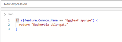

CassidyWheat
 After trying to code, this is the issue that I'm running into. Currently, I have a drop down menu for Common name, Scientific name, and Weed class and I'm trying to link them!
Do you see anything off with my attempt at the code?
CodyPatterson
MVP Regular Contributor
Hey @CassidyWheat
That was my bad, I used the wrong equivalency check, I corrected it in my original reply, but this here should be about what yours should look like:
if ($feature.Common_Name == "Eggleaf spurge") {
return "Euphorbia oblongata"
You're just missing the double quotes after spurge and the ending curly braces.

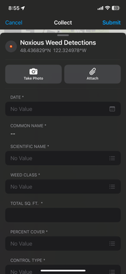

It looks like I'm unable to select any common names from the Field Maps app when I try this code!
CodyPatterson
Hey @CassidyWheat
You may have placed this expression on the Common Name field itself, I believe you should be able to take that expression off, and then apply it to Scientific Name, and it should now let you choose the Common Name I believe!
Cody
