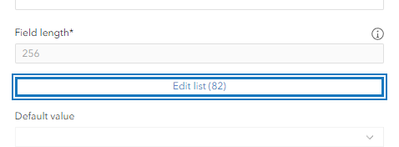

What I end up doing is have a master list in google sheets that I keep updated. Every time I have new updates to the list I download it as a .csv. Then in field maps I click the combo boxes that need updating > click on "edit list" > then drag and drop the .csv into the list editing pop-up window.
Screenshot 2023-12-05 113510.pngScreenshot 2023-12-05 113510.pngScreenshot 2023-12-05 113456.pngScreenshot 2023-12-05 113456.png
But I need to repeat this step 20+ times since I have  multiple combo boxes that use the same dropdown list.

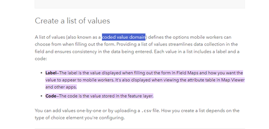

So technically: label is what the data collector sees and then code is what gets recorded in the attribute table. However, even though I set it up this way, my attribute table still records the label value and not the code. I am assuming this is a bug- Documentation about form configuration and list of values Screenshot 2023-12-05 115734.pngScreenshot 2023-12-05 115734.png
Anyways- the .csv needs to be formatted a specific way for the drag & drop option to work.  More info about it here.

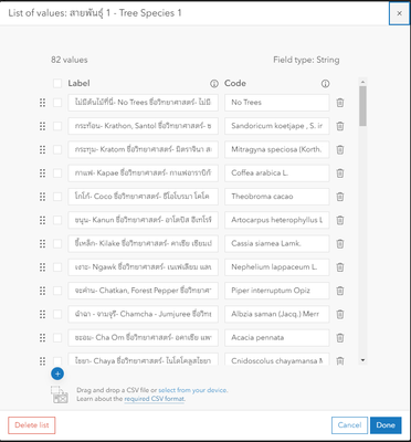

Ultimately what I do is create a two column list in Google Sheets. Do not include headers (it will turn into a list option). Even if you want the label and the code to be the same value, you still need two columns for field maps to read it correctly.
Screenshot 2023-12-05 120559.pngScreenshot 2023-12-05 120559.pngScreenshot 2023-12-05 120445.pngScreenshot 2023-12-05 120445.png
Make sure to organize the list A-Z (or however you need to organize it) prior to dropping it into field maps so it is easier for your field data collectors.

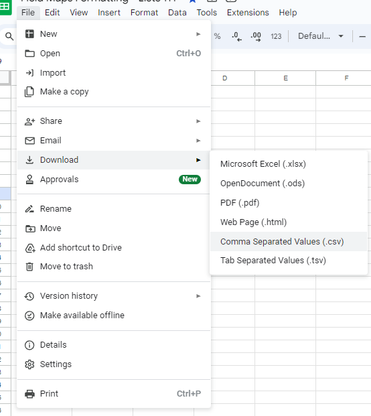

Then in google sheets I go to file> download > .csv.

Then I drag and drop that badboy into the field map's "edit list" pop-up window.
