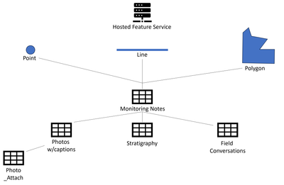

Here's my schema with relates as the lines.  The point/line/polygon features are all a 1:1 relate to the monitoring notes and the tables under the monitoring notes are all 1:many. The related records will show in the pop-ups under their appropriate tables, but I don't think you can add them to the forms for data collection yet.
My setup that I'm currently testing is to enter the point/line/polygon data in Field Maps, then you open the pop-up for that feature and tap a link that launches Survey123 with a blank survey if there is no related monitoring note record or if it finds one, it opens it for editing.  The tables related to monitoring notes are all handled as repeats in Survey123.
If you go that route, the related tables aliases cannot have spaces or other special characters not allowed in the Survey123 Connect xlsx 'name' column. When you publish a hosted feature service in Pro 3.1, it uses the aliases of feature classes and tables as the name of the hosted feature layers and tables.  So for example "Monitoring Notes" should have the alias as something like "MonitoringNotes" or "Monitoring_Notes".
There's also an issue with Field Maps and Arcade for passing q:queryparameters to the custom URL schema  to find matching records from Integrate with other apps.  The query has to be formatted a very particular way and passing it through UrlEncode() will mess it up. I appended the query for the global id after encoding the rest of the URL, which worked with web maps. Field Maps however would generate the URL with everything in the query except the global id value. It will only pass it through UrlEncode().  I've got a solution that I figured out yesterday. It works well and Esri tech support liked it too.  If you're interested in pursuing Field Maps/Survey123 integration let me know and I'll be happy to share it.

Thanks for posting your schema diagram and the part about the aliases. I'm a bit confused about "The related records will show in the pop-ups under their appropriate tables, but I don't think you can add them to the forms for data collection yet."    I've added related records to the form in the map viewer but I haven't gotten to the testing phase in field maps yet. So this is  a new one. 😞   My schema diagram is much more complicated with many 1:many relates so this all just tells me I need to start small and take it all the way through to Field Maps to see what's gonna work. I also have not thought about using Survey 123 because of the 1:many relates.  I would welcome the solution on Field Maps/Survey123.  I may be headed back to the drawing board on this.
This has been working on a much smaller scale for one region of Florida but was built before form designer or the new map viewer etc. etc. and it worked great in Field Maps. Oh well. Thank you so much.

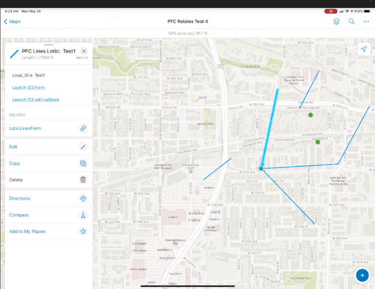

If you have several forms it is a great workflow.  Field Maps is good at spatial to get the crew to the correct sport.  123 is good at forms so we launch all 15 forms from Field Maps pushing over the Key and other config variables.  Then they all link together using relationships classes. Then I have a call back that flips them back to Field Maps on a save. Works slick.
