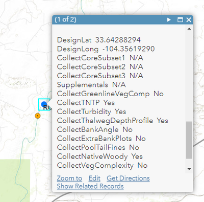

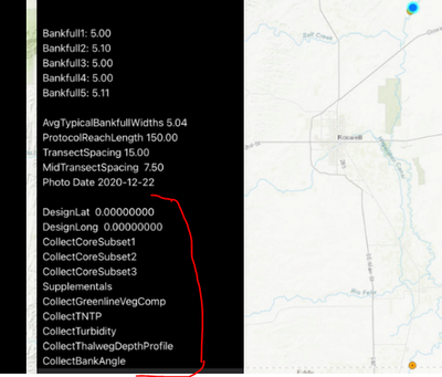

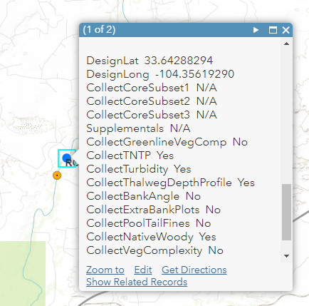

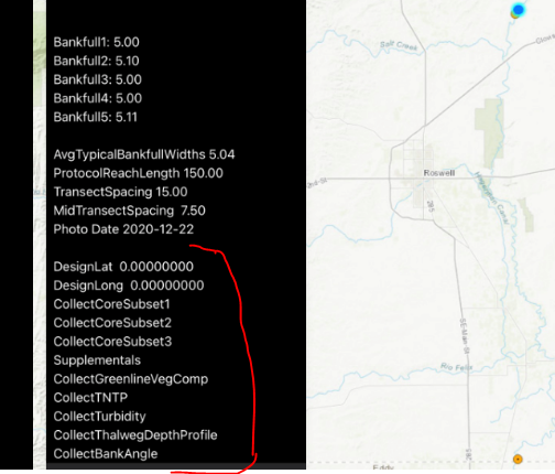

The FeatureSet commands seem to have gone out again in the latest update to Field Maps.  Not sure when but all my test maps that were working are now broken.
I am going Production on this now and at the last hour nothing is working.
My code works in the web map great so I do not think that is it.
But now in Field Maps all are Null or 0

Ok I may have tracked down the issue.  It breaks when I try to give it a field list.  But it only breaks on the app.
This does not work
var sql = "PointID = '" + $feature.PointID + "'";
var tbl = Filter(FeatureSetByName($map,"Points", ['CollectCoreSubset1'], false), sql);
var val
for (var row in tbl) {
    val = row.CollectCoreSubset1
return val
But this does
var tbl = Filter(FeatureSetByName($map,"Points", ['*'], false), sql);
var val
return val
I also tried 2 fields and making a field a objectid but no.
I had just changed this to make the calls faster since my popup is getting slow.
Does this make sense then?  I found it on accident when I tried a diff expression.
I tested with geometry true and false but no diff.
So it looks like something with listing fields breaks the app.
Well at least I can change my code for now.  Let me know what you find still as the calls will get slower returning all fields.  In fact my pop is now 5.5 seconds on a iPad Pro and 13 seconds on on a regular iPad!  Web map slowing down also.
Hope this helps someone.
