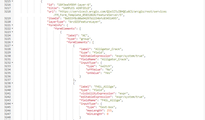

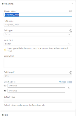

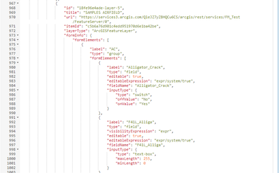

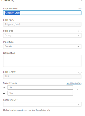

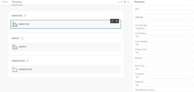

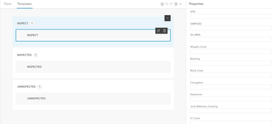

I am unable to successfully duplicate an entire form from one map to another using the method described in this post.  I am able to get most of the form on a new map, but the lists for radio buttons and combo boxes do not transfer, as well as the templates. All maps have the exact same symbology and fields, just contain different data within the tables. Is the information contained somewhere else in the JSON? Or do I just need to recreate these every time?

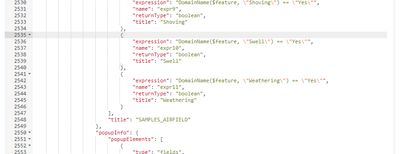

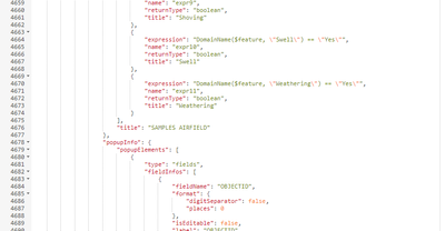

@SeanBabcock22  I tested this functionality this morning, specifically looking at the data types you mentioned and I didn't have any issues with the JSON copying over. One thing I did do, to make sure I got everything, was to copy everything from the "layerType" line until the }, in the line directly above "popupInfo", you will need to make sure you update the "title" at the end of that bunch of code.
I then highlighted the "layerType"  (line 😎 in the new map and pasted in the JSON from the form I wanted to copy. It's possible you may have missed a few lines when copying over the JSON. I hope this helps.

I have attempted this again without any success. I copied and pasted just as you described but the results are not any different than my other attempts. I have attached some screenshots of the "test" form vs the "template" to show the differences. I'm clearly missing something here and would appreciate any other tips!
