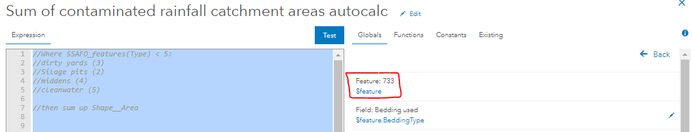

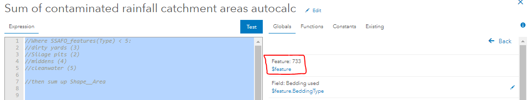

In AGOL Field Map, in a calculated expression, is it possible to control which $Feature the "Test" button runs the code on? It defaults to the first record and field in the table, in my case 733mm of rainfall. I would like to test the code on different row in the table. How can I do this?

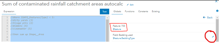

You can edit the values used for testing with the pecil symbols right of the field names.JohannesLindner_0-1668686328838.pngJohannesLindner_0-1668686328838.png

Hi @JohannesLindner, thanks but I need to change the $feature from the first record in the table (OBJECTID=1) to OBJECTID=34 and hit the test button on that. It doesn't seem to be definable.
JohannesLindner
MVP Alum
You can't say "use this feature for testing".
You only can edit the field values it uses for testing.

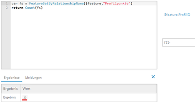

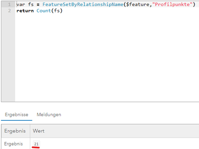

Let's look at an example: Just return the count of features in a related table.
With the default $feature:
If I change the value of the field that is used for the relationship (it was 724):
Think about it this way: When you start the expression editor, it loads the values of the first feature and uses them to test and validate the expression (at least that's what I think it does). At this point, it doesn't have an actual connection to the feature anymore, it just uses the values. So to test the expression on different features, you can't change the feature it uses, you can only change the values.

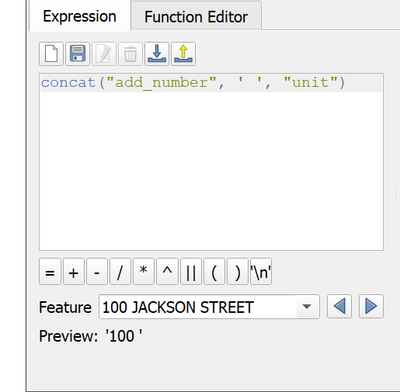

That said, I think it would be a fantastic addition if it were technically possible to do so. You should post an Idea about it, I'd totally vote for it! What you're describing is a much-loved part of QGIS for me; everywhere expressions are used in Q against a layer, you can toggle which feature to preview the output for. Having something like this available in AGOL would make building / testing expressions in Arcade that much more useful.

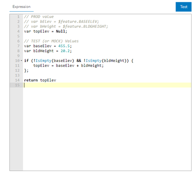

I no longer bother testing with a specific feature; it is rarely convenient  or predictable enough for me.  Instead I just provide MOCK or TEST values.  When I go to production I comment out the test values and uncomment the production values... the opposite is true in development or testing.  I make sure I clearly identify the prod or test values with code comments.  Whether I'm writing the expressions or reviewing expressions others have written, MOCK values are required piece of the puzzle for our team.  This means that I don't have to know anything about the feature's schema or whether I'm looking at a feature of interest.  I can easily change the MOCKed value to test various logic or math without taking my attention off of the expression.
This can be done with $Geometry and featureset data as well.
